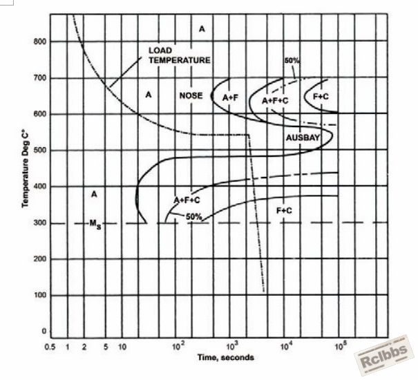

发表于 2013-9-8 01:41:35 | 显示全部楼层
我说的是奥氏湾淬火,见附图。
Isothermal transformation diagram for 300M steel showing load cooling rate during ausbay quenching.
发表于 2013-9-8 06:05:16 | 显示全部楼层
ausbay quenching第一次听到!学习到了。
签到天数: 2862 天
发表于 2013-9-8 11:55:28 | 显示全部楼层
过去我国也有这个工艺,但是用盐浴炉。现在国外是真空炉:With advances in computer-based control systems and process capabilities, specially-designed integral oil quench vacuum furnaces can be used for ausbay quenching.

ausbay quenching奥氏湾淬火,我也是第一次听到。好象就是国内所说的等温淬火。
