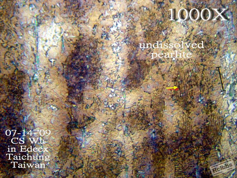

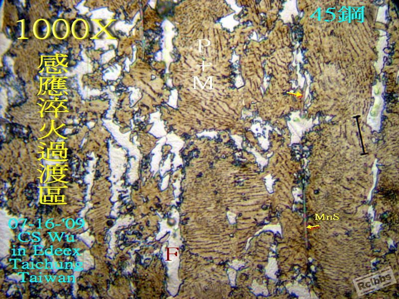

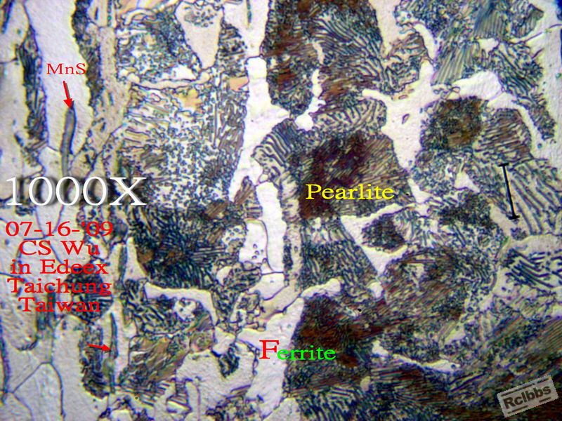

For those who are aimming at improving their English ability.
Photos were taken at the transition zone of an induction-hardened AISI 1045 part.
Please note the partially dissolved pearlite in the matrix of low C% martensite.
Photos like these, you can only see them  once in a long while.
You can only see them here and nowhere else.
White patches are ferrite
