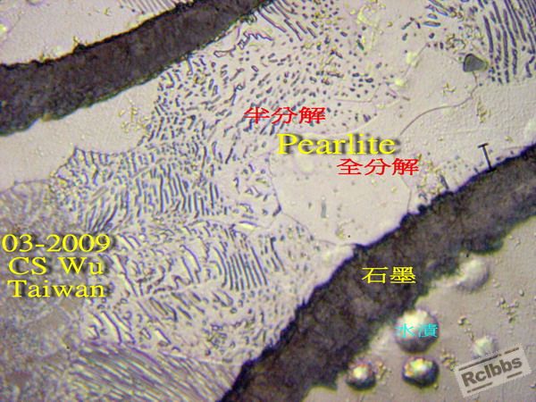

 楼主| 发表于 2009-5-6 21:22:27 | 显示全部楼层
回复 2# 盛丽丽 的帖子
我又要練習英文寫作了: 不給答案 只給一個思考方向
Principle of solidification of cast iron.
fast cooling → more graphite nuclei → smaller graphite nodules → shorter distance between graphite nodules.
On cooling thru A1 temperature, fully pearlitic matrix is obtained at the very begining. Cementite in pearlite then gradually disintegrates into ferrite and free carbon. Free carbon atoms diffuse to and gather at surface of eutectic graphite flakes or nodules at the form of temper carbon.
Think of a graphite nodule as a black-hole that sucks-in any C atoms near-by.
[ 本帖最后由 leomet 于 2009-5-22 07:37 编辑 ]
