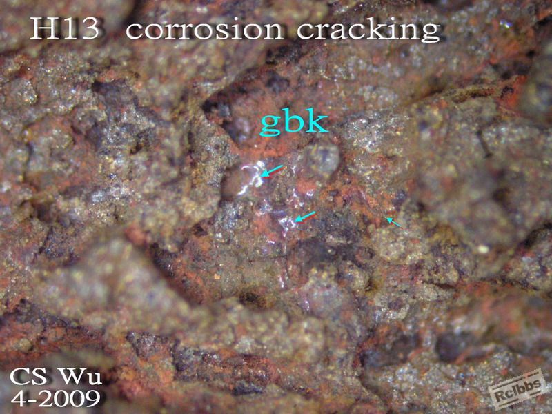

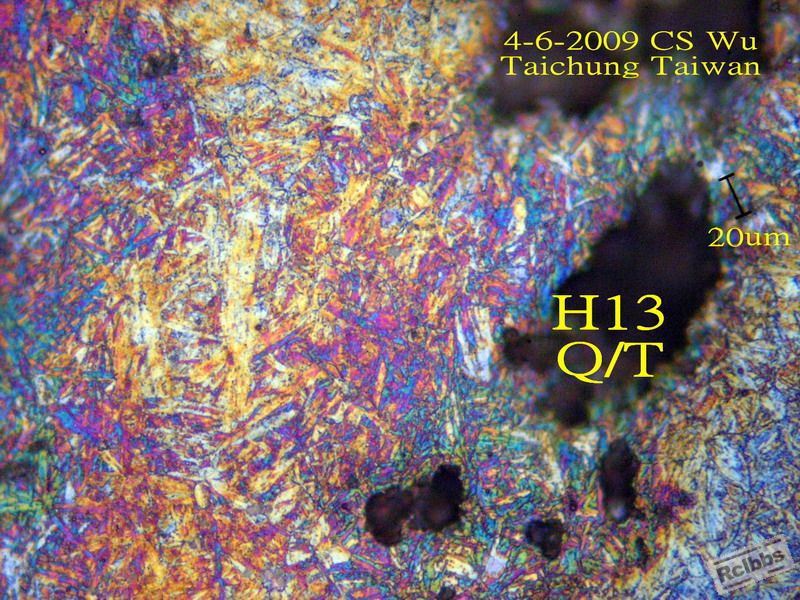

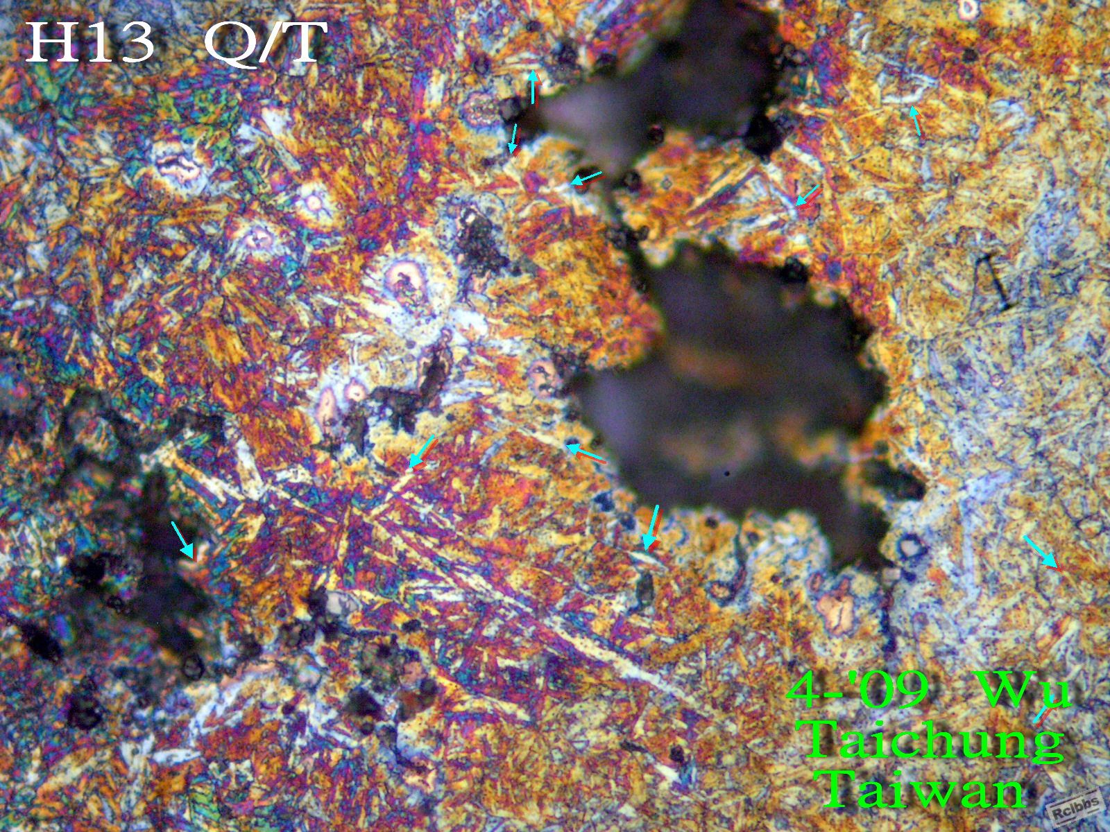

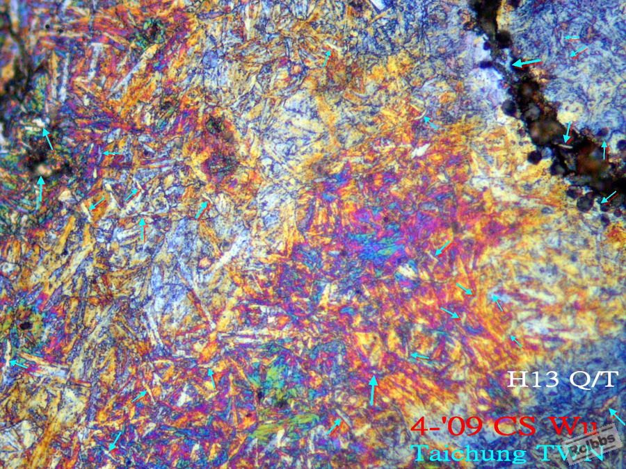

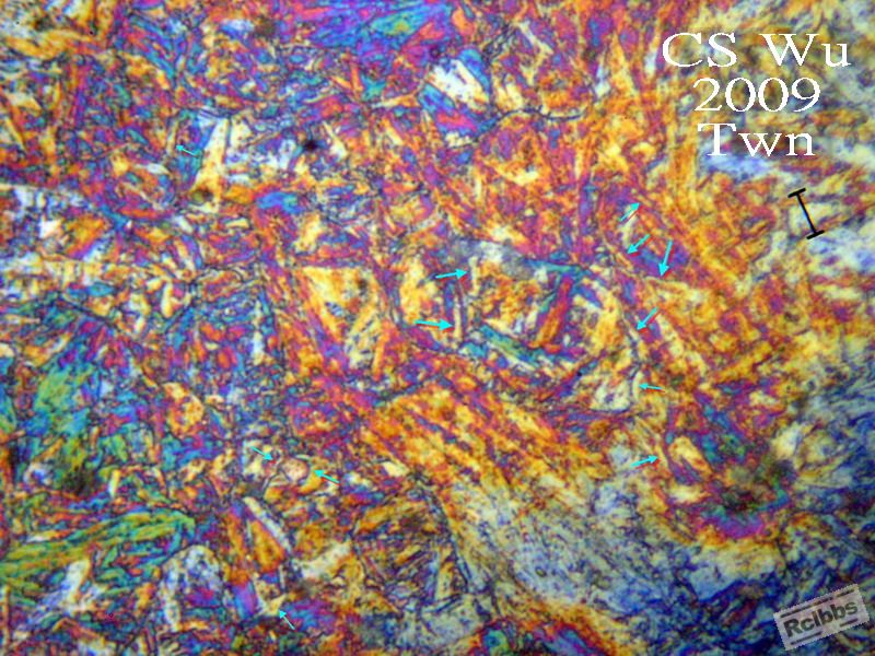

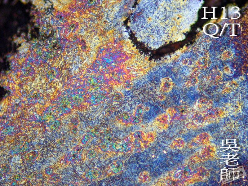

Micrographs that feast your eyes.
Note the gb carbides in the crack
on upper right of the photo 325.
These are micrographs from the
fractured H13 stess ring
because of corrsion in cooling
water channel.

gbk 1.jpg : 銹蝕嚴重的破裂面. 碳化物(滲碳体)就是不銹, 所以會發亮.
