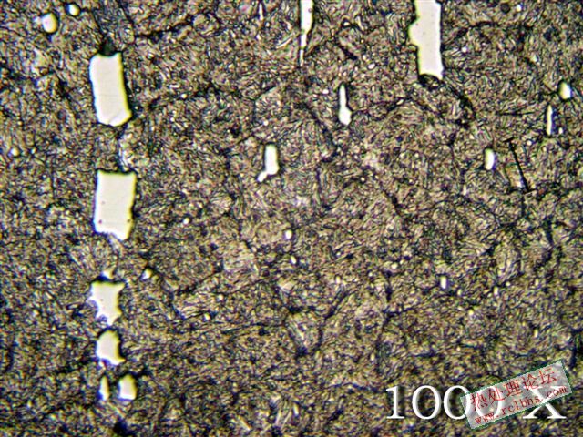

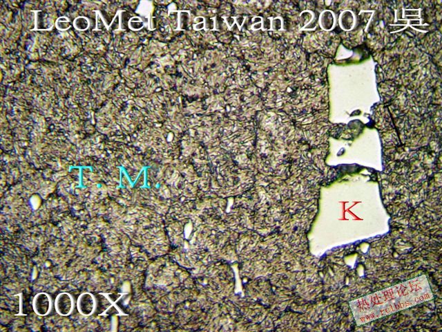

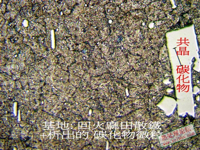

YXR 3   Q & T 金相照片
Time for English:
This is a matrix-type high speed steel
in which the amount of carbide particles is reduced
to increase its toughness at the expense of its wear resistance.

看不懂! 楼主会中文吗?能不能用中文翻译一下?

这是马氏体高速钢,减少高速钢组织中的碳化物颗粒去增加韧性,但是牺牲了磨损抗力!

这是马氏体型高速钢,少量的颗粒碳化物增加其韧性却牺牲了其磨损抗力!
